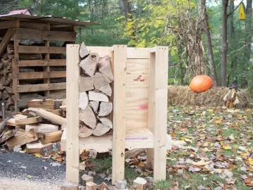

H-Frame for cutting splits to length (PICS)
Loco Gringo
Feeling the Heat
Jan 17, 2011
416
Western North Carolina
Sharing to help any newcomers who may have logs or splits that are a little too long for their firebox. I can cut a little or cut a lot by dividing the stand like this and I find it safer the higher I can stack them prior to cutting. There are screws on each side that I can hook a bungee cord to and pull it over the stacks giving it added safety while cutting.
  • [Hearth.com] H-Frame for cutting splits to length (PICS)
Nice little setup...would help me a lot.
Now, I just gotta find a place to stack the uglies.
Nice - might try that myself. Cut about 3 cord about 3 inches too long last year - forced to burn E/W if I don't cut them down and my stove does not like E/W burning. Thanks! Cheers!
Very cool. Thanks for sharing the idea.
I have half a cord of oak I got for free that I think I'll cut in half. The splits are mostly about 18 to 20 inches and cut in half they'd fit n/s in my stove. As is a lot will barely fit e/w while the longer ones won't fit until cut. Maybe I need to make something like your H-frame.
I like it! Thanks for posting.
Very cool. I had to enlarge that second pic, because my very first impression was you were using the empty side as a football target. :lol:
can i please see more pics of your shed?
Thats exactly what I need, I have over 1/2 cord of rounds and splits that are 3-4 inches too long. Thanks for the pictures.

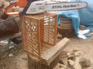

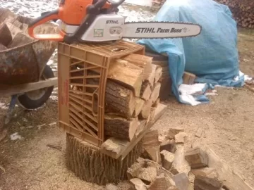

Even better than THIS?

Ill get some today Steve. And wood-fan-atic, thats exactly what I was using, just a different color crate.

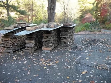

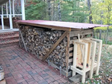

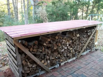

Here ya go Steve. 5 pallets using a few braces and I had a sturdy wood rack for nothing. I had the red roofing already but I bought the 2x4's to keep them supported. So for around 12 dollars I am good to go. As you may see I have my 8x16 porch lined with white oak to keep my girls from falling over. Ill burn that as a last resort in order to keep it in place as a border and bench type lining. I have all flat slab splits on the top to keep it neat and useable as seating. All together what yousee is about 30% of my supply, but some is still in rounds to be busted this winter for 2013-2014.

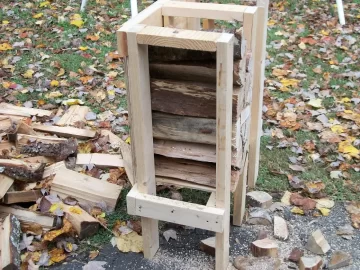

Since we all like pics so much I spun around and took another of some oak that I scooped up this month. Split about 2 years ago.
