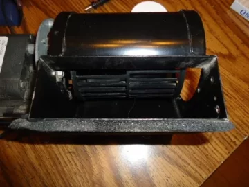

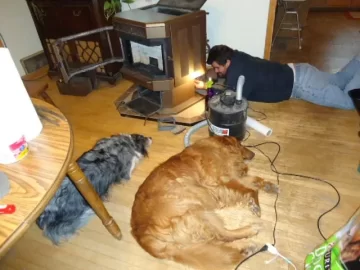

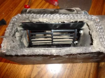

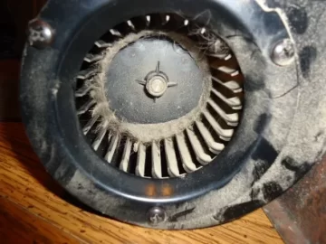

took out the room fan and cleaned that, lubed it and sprayed the fins with grafite spray - the one photo is of 2 of our dogs supervising the Mr putting the fan back in.

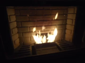

rehooked everything and held our breaths! and low and behold - FIRE!! will have to keep an eye on it to make sure it keeps working on auto.
