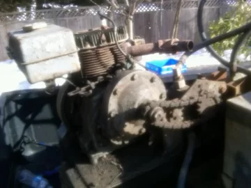

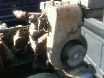

So I got an old homemade splitter that is real nice and beefy BUT I have no idea what the engine is. Help please!
Seller said it was a Wisconsin and he was a knowledgable gentleman but I just wanted to see if anyone could point me to an accurate model number.

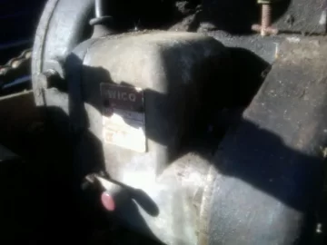

Looks like a Wisconsin to me. You will also see them on older cement mixers. Isn't there a number on the plate?
The starter looks like a wisconsin to me. What do you need a model number for?

On the magneto it says Y-111. Mainly I just want a carb kit because one of the bushings is leaking just a little so I figure there is a seal I should replace.
