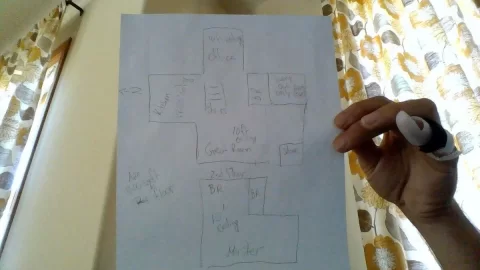

That does complicate things. Moving the heat could be an issue. Are there cathedral ceilings involved too? Can you post a sketch of the floorplan?
Pretty rough drawing as my pinky is broken. Hopefully that gives some idea. I could take actual measurements if that helps, but it is apx 1100 sqft per floor
  • [Hearth.com] Good Bye Propane
I can close off the workout room when the sun is not hitting it, but otherwise it provides decent passive solar heat. The downstairs MIL apt actually stays warm really well once warmed up. My mother-in-law literally lives in the MIL apt! She has a small space heater that warms it up extremely quick in the am. From there she is good for the day and she likes to sleep cold so overnight is not a factor as it stays warm enough.
