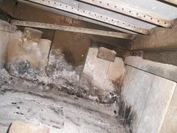

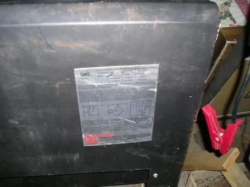

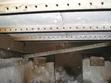

Great idea, thanks fossil. I checked all over and what I found was a snapped off bolt that holds the back tube, no plate were the blower goes on the back and some minor damage on the fiber board. No signs of warping any were and the fire brick looked good. Any comments

The "bolt" is just a stainless steel self tapping screw so getting the rest of it out of the hole should be easy and the replacement is twenty nine cents at the hardware store. The damage to the baffles and the tube are just from banging around in the stove with a poker. If you turn the boards over I bet the other sides are still smooth.
I would use that stuff for negotiating purposes but if the stove body, door and glass are in good shape I would buy it for the right price.

The boards should be ok. If you want to change'em out at some point they are $65 apiece.
Thanks BB, now my search begins for a set of legs.
The boards in my 30 have a couple "dinks" in them, just as BB says... from banging around with the poker. Stove still burns just fine.

ther than the tube , stove looks pretty good to me , nothing realy catches my eye. the fiberboards are fine , no reason to replace them as they sit. i'd say you got a heck of a deal.
