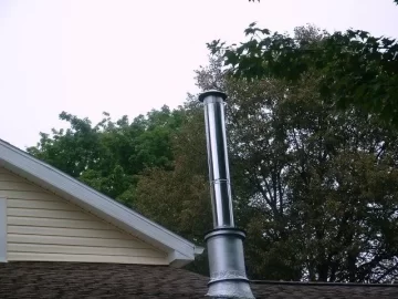

Hello John, just went thru the same thing here. I did not want to remove all of the 8" triple wall chimney. There was 6" class A chimney pipe for 57.00 for 3' so I removed the 8" and ran the 6" in it's place. So it is like a class A inside a Class A. I have since this picture was taken replace the cap with one made for the 6".
