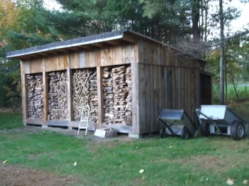

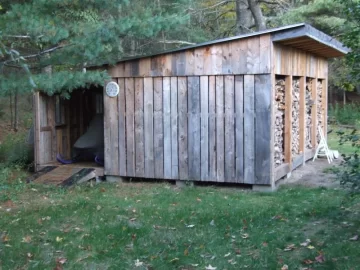

I went with a half inch gap between my boards -- kind of a board and batten look minus the batten. Opted to keep the gaps relatively narrow since the wood is pretty much seasoned already (just figured leaving some gaps open would just allow the wood to keep seasoning albeit at a more slower rate) . . . and I didn't want too big a gap to allow a lot of snow to come through during the winter. So far this has worked well . . . although in retrospect I suspect the gaps really don't make much of a difference in the continued seasoning of the wood (although they don't hurt things either.)
really nice shed jake.
I like small gaps in the siding, I dry my wood outdoors and put it in the shed after 2 years. I want to keep the rain out.
Mine is similar to Jake's. Approx. 1/2" gaps all around for a bit of airflow, although the wood has been drying for over 2 years.

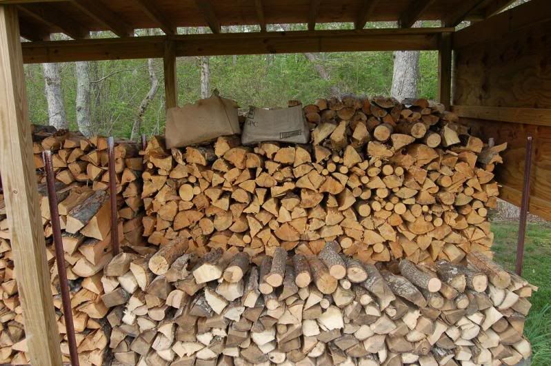

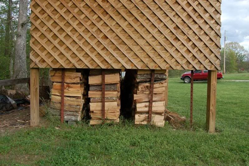

I have my shed "partitioned" with metal fence posts. I have 4 that line up with the middle 4x4's, and the 4 more down each far side of the shed. I use them to help stabilize the stacks. I also leave about 4 to 6" between rows for air flow.
Side view:

Front view:
