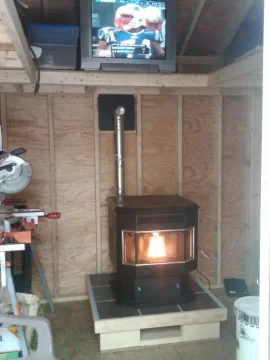

Recently purchased a Glow Boy shop pellet stove. I cant figure out how to make it burn hot. I can get it up to 275* out the blower and thats it. I have an Avalo Astoria and I can get up to 550* out of it with the same pellets.
The glow Boy has a 22' - 4" exhaust 90ed on the back and then straight up. I thought maybee the heat was being sucked up the stack seeing that its 22' long, so I restricted the fresh air intake temperairly to see if a change, no change. I adjusted the high setting on the pellet feed to run at real hot. Yes more pellets make a bigger flame but still 275* reguardless of the blower motor setting. With the blower setting on the lowest and the pettet rate fast (faster than I like) still only 275*. Whats going on????? Any ideas.
The Astoria kicks out 3 X the heat with less pellets.
