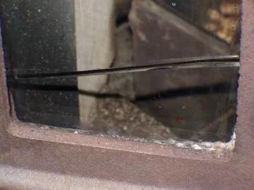

If the glass has only a small crack, like in a corner or the lower edge, it may not be a safety issue since the air leakage issue isn't about air leaking out into the house, but air leaking into the stove where the burn chamber is in a state of suction from the exhaust blower. If there is no shattering of the glass and it is still held firmly in the door, you might want to consider using the stove temporarily as it is. But the best case would be if it is under warranty and could be replaced for free. Here's a photo of the crack in my stove door, which has no effect on it's operation

Yes it is still under warranty so maybe they will replace it. It is just cracked so I will have her try it and see. The glass place wanted $180 and the vendor wants $70 so no brainer there. The glas place did say if it didn't shatter into a bunch of tiny pieces then it isn't ceramic glass and tempered glass is only $20. Well, it didn't shatter into tiny pieces so this leaves me wondering.

Shes gettin a new one from the vendor. It turns out it was just a crack. I fired it up today and it ran fine, no low vacum errors. I, of course, wouldn't leave it running like this un-attended. I just wanted to see if it would pull enough vacum to run and it did. That was a suprise because there was about a 1.5 mm gap in the crack. Anyway the new one should be here soon not that she will need it. It's going to be 82 tomorrow.
