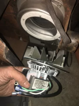

The old Pellet Pro I or Pellet Pro II Harman stoves and VC Reliance pellet stoves have Exhaust or Combustion blowers that have 3 bolts to hold the motor on the exhaust housing. Therefore the only way to clean the blades and exhaust chamber is to remove the entire exhaust housing. This can be difficult. However I newer quick change housing can be cut and modified so a new Blower , Harman or any exhaust blower brand with a 6” round mounting hub can be easily installed!
Don't forget to seal the new quick change housing to the inside of the Harman exhaust flange with High Temperature Silicone RTV,
Pic 1 - Old Blower and housing
Pic 2 - cutting the new quick change housing to fit. New housing has studs with nuts for easy exhaust blower installing and removal.
See hole cut off with jig saw on right side
Pic 3 - Mounting holes may also have to be elongated with a drill bit to align with holes
Pic 4 & 5 - New 1.75 amp High Quality Exhaust Blower!
Pic 6 & 7 - Harman Pellet Pro II
