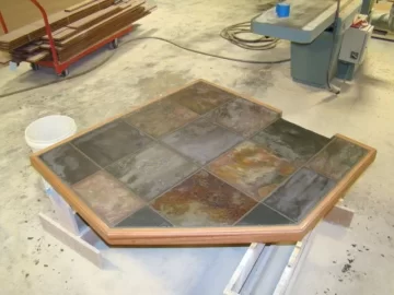

I would use sanded grout. This type of grout comes in many colors, has some flex to it and can do a joint up to a half inch. I used this for my hearth and I have 1/4" grout lines also. I also think you might want to go with a tile mortar instead of concrete also because the mortar also has some flex. They have quick set and regular depending how long you want to wait before grouting. Also if you are going against wood trim or are wrapping the hearth in wood they sell a grout caulk that you can use to grout against the wood so it does not crack and it matches the grout perfectly. Check Lowes or depot they have a good selection. Good luck!
  • [Hearth.com] Getting the rock for my hearth tomorrow... Need a little advice
Very nice hearth! Mine is the same shape but the tiles will be larger and laid out different. What would crack if I didn't use the grout caulk, the wood or the grout? The mortar will be spread directly on the micore which I think is just overpriced durock. I'll look into using some mortar. Thanks for the advice!
wood expands and contracts so you will notice a hair line crack around the outside edge where the grout meets the wood over time. If you use the caulk it will move with the wood and not crack. good luck
