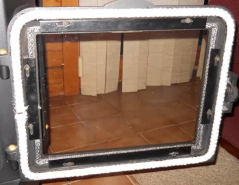

I bought window gasket material from Englander several years ago. That came with adhesive already on it. I just had to peel the backing off. It went on really slick. I don't know if their door gasket material is the same or not.

As I posted a while ago, bought the "EarlyBird" gasket set from Englander and it was a VERY easy replacement of the window and door gaskets. Door gasket was very straightforward, and I agree with Subsailor about the window gasket.....the pre-applied adhesive works GREAT!.door gasket is different, comes with a "toothpaste tube" of high temp rtv. still pretty straightforward to install
Used....it's an '04 model.....time for new gaskets, IMO.
