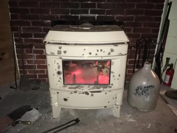

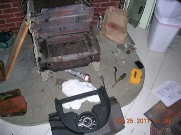

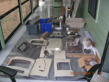

Well, starting to do pre-season prep on my 1995 Seneca (model #2170). It has had two full rebuilds, plus in-between tweaking as needed. A lot of porcelain chipping/cracking. Typical inner top-zone needs (inner top, web, damper, baffle) over the years. Full rebuild about every 7 years. Gone through several catalytic converters.
With dry wood, burns so clean that annual liner sweeps result in barely any dust. Looked at near stoves over the years, including recently, but haven't seen anything that would be a big improvement. would like about 10% more efficiency, and definitely a longer overnight burn time.
Other than that, no complaints.
