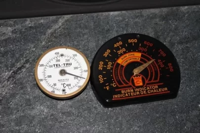

Fire has been going for about 10-15 minutes. The air controls are completely open and the pipe damper is open. Top center stone is at 377°

5-10 minutes have passed. Air controls are still 60% open with the damper open. Top center stone is at 412°

10 minutes have passed. The pipe damper is closed with air controls still at 45% open. Top center stone is at 519°

This photo shows the control settings at this point (note that the Rutland is lagging behind in temperature readings):
5-10 minutes have passed. Air controls and pipe damper remains the same. Top center stone is at 545°
5 minutes have passed. Air controls are now closed. Pipe damper remains closed. Final shot. Top center stone is at 595°
Stove topped out at 610° briefly before coming back down.
And there you have; A Hearthstone at 600°.
