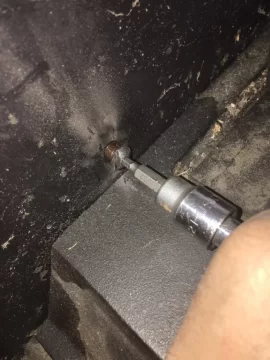

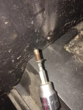

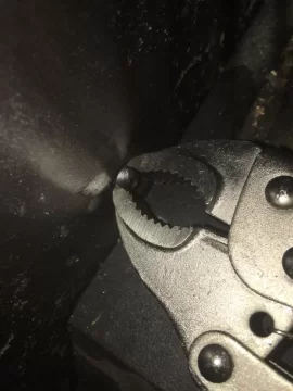

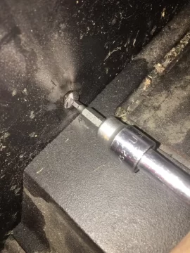

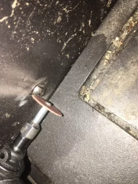

My trick of the day was just to remove this bolt on the shroud just to get the stove in the door!
The round head was already stripped in the sunk in head so the ratchet and the socket could not cut the mustard and crack that bolt even with wire wheeling and spray PB Blaster lube on it!
So I pulled out the Dremel and installed the small cutting wheel on it and cut a flat spot on each side to get a grip with the vise grips and bingo!
See Pics
Pic 1 - cut the flats
Pic 2 - attach the locking pliers
Pic 3 - push and turn and heat a crack - Bingo
Pic 4 - put the ratchet and hex head socket in and it is working
Pic 5 - just keep turning
Pic 6 - Bingo - It is out![shock !!! !!!](/talk/styles/default/xenforo/smileys/shock.gif)
