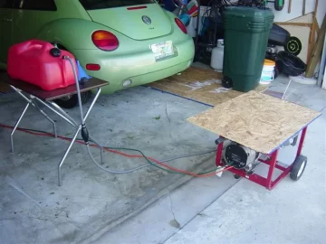

I have been through several hurricanes while living in Florida and have nearly a month of clocked generator time. I use the el-cheapo Brigs and Stratton 3250 watt job seen in the photo. I have powered $2000 LG fridge, $2000 Samsung TV with DIRECTV box, gas driers, 5000 BTU window A/C and various other circuit board based appliances. I have never toasted anything to day. Keep in mind that I did not run all this stuff at one time on a 3.2KW box.
  • [Hearth.com] Generator-UPS-Pellet Stove
