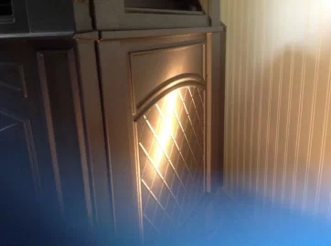

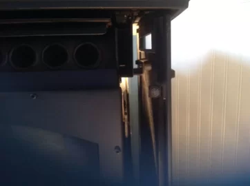

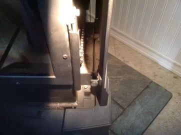

Any one ever replace a convection fan on a GC60 , have to remove side to get fan out, loosened the 4 nuts on the mounting brackets for the side, but when I lift it it hits the top ?
Am I missing something?
GC60 convection fan GC60 convection fan GC60 convection fan
If it is like my Enviro M55 Cast....You have to remove the top first.
On the Enviro it is just 2 hex bolts under the hopper fill plate.
Once the top is removed you loosen the two exposed side bolts from inside the upper edge and then lift the side panel up and off.
Good Luck,
---Nailer---
