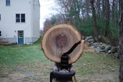

I've fallen in pretty serious like with the big electric option this past year. All the advantages of electric you mention with some oomph.

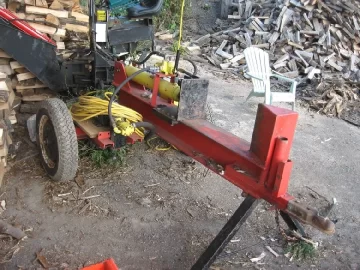

Given where I use mine, electric is not an option. I'd much rather deal with filling the gas tank and changing the oil than stringing out and wrapping up the cord. My splitter doesn't stay out overnight.
As for short stroking, I got that beat with my mod.
