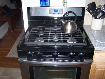

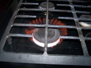

I noticed that when i light the stove the flame in no longer blue, its orange. Does anybody know what would cause this?? Whirlpool Accubake, the stove is two years old.

looks to me like it's starved for primary combustion air.
Any way you can post a schematic of the burner system?
It may be as simple as an air shutter adjustment...

Do all burner burn this color or was there a recent spillover on that burner(s)? If it is just that burner, my guess it the burner got junk into it. Pull the grate, pull the burner cap and clean thoroughly.
If this is doesn't clear up after a minute or two, open a nearby window or door. If that changes the color of the flame there is a danger of increase CO or low O2 in the room. Find out the cause and leave a window cracked open.

All the burners burn the same orange color.

After cleaning the jets and anything else i could think of i still had the orange flame. To keep it short and simple i pulled the stove away from the back wall about two inches and now it works great. The stove was starving for air.
