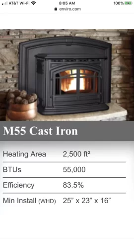

Also, I'm looking for a narrow depth pellet stove to install. I have not purchased a stove yet and due to the narrow place Im dealing with I need to find a stove with a depth around 18 inches. It was your typical corner mounted direct vent LP fireplace.

Enviro, quadrafire, cofortbuilt, lots of inserts to choose from. [Hearth.com] Gas insert to Pellet Stove
