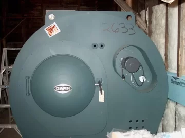

Do any of you Garn guys know if there is an actual key for the keyway on the blower/motor shaft. I see two set screws and a keyway, but no key.
Thanks!!
Tom Thanks, found it. After I got it assembled along with the clean-out cover, I plugged it in. WOW!! Talk about massive amounts of combustion air. The inlet and vent pipes weren't connected yet, and the loading door was open. Created a huracaine in the building and almost sucked me through the loading door. I can hardly imagine what it's going to be like with 100lbs of oak ablaze in there :-)

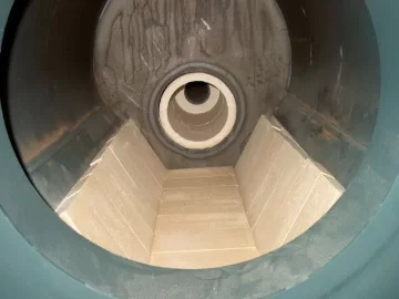

A shot of blower assembly installed and a shot down the throat of the dragon. Really just me playing with the camera....................
