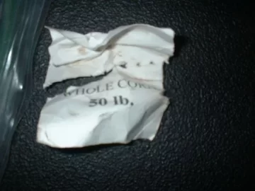

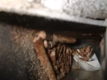

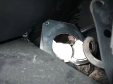

This morning I had a pellet bridge in the drop shoot as the pellets were so long. I aimed my camera up the shoot and in the picture it looked like a piece of plastic bag was rapped around the auger.
So I emptied the hopper and pulled the auger. It was a 2 by 2 paper tag. The tag says " whole corn 50 pounds". Interesting.

Here is the proof.

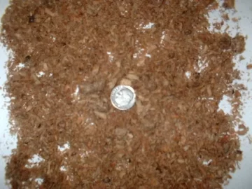

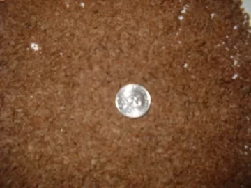

I did a water test on the pellet this morning.
I took a handfull of the future fuel and placed it in a glass of water.
I also placed a handfull of "greene team" pellets and did the same.
The greene team dissolved completely within 3 minutes.
After twenty minutes the Future fuel still had complete pellets.
Then I used paper towels to squeeze all the water out of the samples.
Placed the samples on some paper and took some pictures.
I think I see what the problem is.
