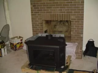

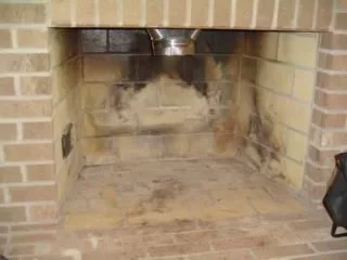

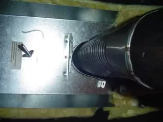

Here is some pics of the direct connect...
