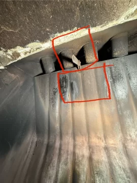

We currently have gas logs in what was originally a wood burning fireplace, an early 80s? Steel “Heatform.” The chimney runs directly through the center of our 2 story log home.

1.) Do I simply cut two of the heatform tubes and a few inches of the box to pull the liner in to the stove? (See Picture with red X’s at cuts)

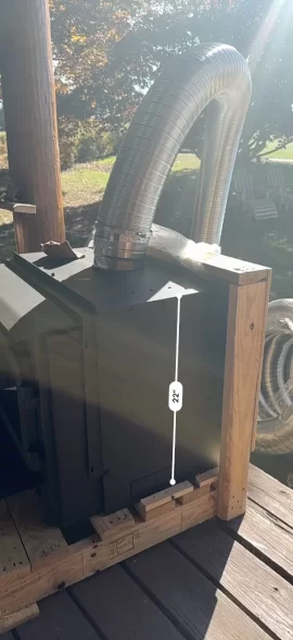

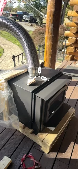

2.) assuming the height works out, Is there any reason I can’t go buy this (or another) used Russo GV-30C (rear vent) for $500 and put it halfway on the hearth and half inside of the fireplace? (Attached fb listing)

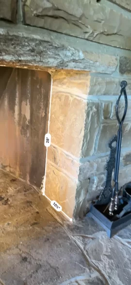

I think the Russon GV-30C may be a side-loading catalytic stove. It probably needs a new cat. The stove would need to sit out on the hearth a bit for side loading. This may require a hearth extension. There is also the clearance to the wood mantel to be considered. I don't have the manual, but it's typically 84" from stove top.

I'd recommend sticking with 6" flue outlet stoves if the intent is DIY. Definitely measure the flue ID on this fireplace before going further.

I know that the Russo has side loading, but would I not be able to also front load? (I’ve never had a wood stove, so please tell me what I’m missing on that)
The used stove seller said the Russo’s rear outlet was 7” and that the Catlytic component was replaced last year
I still have to get on the roof to measure for my exact liner length and to confirm the flue width.
Most modern stoves take a 6" liner. A 7" liner is an oddball so it costs a lot more. The Russo has a large front door which can lead to smoke spillage when reloading via the front door., especially on a short, one story liner. They used to have a big andiron in front which also made front-loading hard. I'm not sure about this particular stove.
