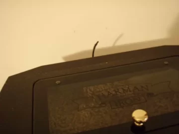

I have mine taped to the back of the stove sticking up about 2" from the top. The installers put it there and said it would work fine. It keeps my house within 5 degrees of what the stove is set at according to my thermostat on my furnace. I think it works fine considering its right next to a very drafty door.
  • [Hearth.com] Free Standing Accentra owners where is your room sensor located?
