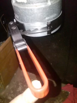

If you take the foam padding of the inside it will fit 4" Duravent and 3" Duravent!

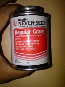

Then if you put the Oil Burner Man's "Never-Seez" silver paste on, you will be able to get it of by hand next time!!
