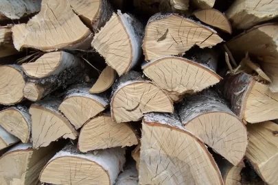

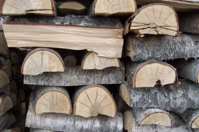

My wood checked & cracked on the ends of the rounds quit a bit this winter.
But Alaska is known for for cold dry air & it definitely shows on my wood that I'd cut in Nov - Dec.
I'm having to burn some of it now & it's doing OK.
I don't have a moisture meter but I'm not sure a meter tells the whole story with so many varieties of wood.
1st pic Nov- Dec cut wood
2nd pic Jan cut wood
all were standing live Alaska white (paper) birch trees.
