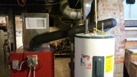

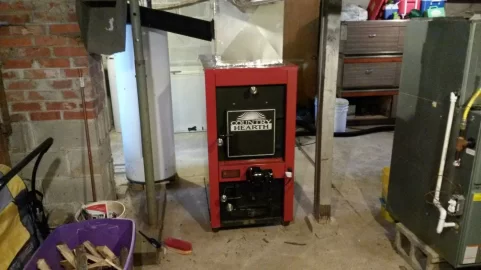

So im posting this in the hearth room because my furnace is basicly like a wood stove with a metal cabinet around it. Its a US Stove company wood/ coal furnace. My question is what should I be running for temp on the outside of the single wall pipe. The setup is 6 ft of 6 inch single wall with two 90s into a masonry chimney lined with 25 ft of 6 inch stainless insulated liner and 5 ft of class A out the roof (some jackwagon knocked the chimney down just below the roof line so that was interesting making that transition.) I get killer draft with this setup and dont want to over fire so I havnt been pushing it too hard but I can still get it to 80 in the house in about 3 hours. Here are some pics of the furnace.

The subject of outside vs. inside flue temps on single-wall pipe has been debated many times here, and several tests have indicated that the inside flue temps are very close to double the outside flue temps, as measured on single wall connector pipe. Knowing that, and reading up on the maximum sustainable flue gas temperature permitted for your chimney / liner, will give your answer. A common max operating temperature for liners is 1000F, meaning you don't want to see more than 500F continuous on the outside of your single-wall pipe, anywhere close to the liner.
My pipe exterior runs around 200F, when the stove is cruising.

Thanks joful I have been reading around 250 to 300 with my IR gun and wanted to make sure it wasnt too low. The firebox is huge on this thing so maybe hotter is better?
Yeah, and I think it's normal for a catalytic stove to have a lower flue temp than an EPA-exempt stove.
Sounds like you are doing fine. Just remember that all chimneys still need heat in them in order to keep that good draft and not cake up. On our horizontal we aim for 400-500 to engage the cat. Once the cat is engaged, the flue temperatures drop to between 300-400 in winter months.

Its a 1602r I actually filled mine up half way yesterday with some oak and ash (maybe 6 large splits) on a hot coal bed at 5 pm and it was still putting out heat by morning. I figured out that if I shut the combustion fan off and close the flap on it, as well as close the air control on the ash door all the way down it cruises nicely at 450 on the firebox and 240 on the outside of the single wall without eating me out of house and home.
