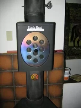

I suppose some of you use them, but I'm just thinking about them now.........
Saw a couple of different versions, but this one caught my eye. Not sure how practical it is, and if I need a damper above it or not, but...........
Your thoughts about its value, ease of installation, overall worth in the long run?

I used one years ago. worked good for me. very easy to install & use . no elbows above it, and definatley no dampers ! seasoned wood only. used proper will move alot of heat. pull the little pipe cleaner back and forth couple times a day to keep it clean. set on auto & let er rip. as far as value, i used mine for 5 seasons and it still worked fine. think i sold it for half of original price. Happy & safe heating.

In a short answer, the list consensus has been they are a creosote factory, designed before the current air tight EPA stoves. They further lower the stack temps which the current EPA stoves are already designed to do. Too cool a stack causes creosote as we all know.

As for the original question . . . I think this question has been answered many a time and the general consensus for all but maybe three members is that on the older stoves they may have had a place, but on the newer EPA stoves they are not all that great . . .
Me . . . I get all the heat I need by heating up my woodstove . . . not heating up my stove pipe.

Without forced draft, you rely on stack temp for stove draft.
With an EPA stove, stack temp is substantially lower than with smoke dragon.
Drop that temp, and where's your draft?
Prof. Richard Hill (UMe Orono) devised various heating systems which had exhaust temp about ambient, but he used forced draft for hot, clean fire. (Like for federal buildings, Audubon Center.)
If reading the instruction manual about what all you need to do if the electricity goes off doesn't discourage you, figuring out how you plan ahead to be home when the power fails will.

A friend of mine has one on his stove. I just saw it yesterday for the first time. It puts out a lot of heat and he likes it, but I don't like the idea of deviating from a stove's original design. Should there be any problems in the future, I would be afraid of my insurance company using it against me.
Now that I saw it mentioned in this thread, it makes sense that running the stove gases in front of a fan would cause it to cool and build up excessive creosote.
That's what seems to be the prevailing theme of many of the responses...........another place for creosote creation.

I had the square type with no cleaning scraper.
It was fairly restrictive new. They it makes creasote and gets very restrictive quickly.
I had it on my EPA stove and took it out. Any heat gain was probably lost because the stove wasn't drafting correctly.
