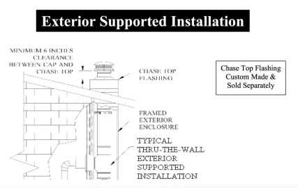

Hello, I am installing a class A flue inside a wooden chase. I am unsure of the height that it needs to extend above the chase? I understand the 3-2-10 rule but am not sure that applies to a chase that is already the highest part of the house. I would rather it be as short as possible
Here is a pic of the chase with the old zero clearance flue that I already removed
Thanks!
