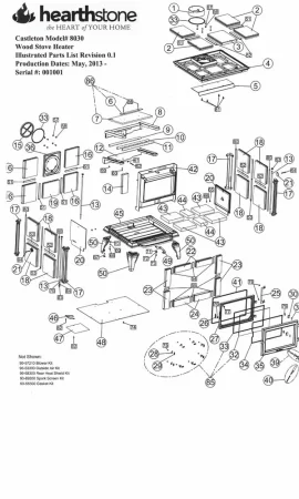

Do you mean that the No. 8 on the photo ? If so is it the Secondary Manifold Top Casting you can remove with all the parts in one step? If so do you have to change some gasket or is it just metal on metal?
There were no gaskets in any of them I have done. And I don't see any in the diagram. I find it much easier and less chance of damaging the baffle than messing around with the cotter pins and pulling the tubes.
Yes for what you said , seems to be a very good idea. Is it heavy to remove or do you need to put some **blocks** ?? under it to help ?
It isn't light but not heavy enough to need blocks. You take the bolt out then lift the back up remove the rectangle tube under it in the back and it drops. One model I think the insert has soap stone panels that need removed as well
