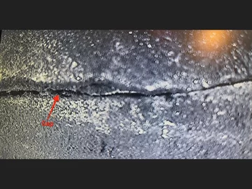

I recently had my wood insert with stainless liner swept as well as my main level open fireplace swept. During the sweep of the upstairs fireplace they indicated that the Lintel needed to be parged. I scheduled that visit and they also said that they would scope the flue during that repair. Once that was complete I received an email (No discussion from the technician) stating that in order to use the main fireplace I would have to utilize a stainless liner and purchase a pellet/Gas/Insert to utilize the chimney safely.
I asked if this is repairable and if I can use it lightly during this winter as we are already in October and there is not much time to search out options and spend the money. Their response is below.
"As we follow industry standards, your fireplace flue would require repair prior to first use as per NFPA211 code standard due to it being gapped and cracked. The purpose of your chimney is to safely vent gases, created from a fire, from your home. Any gaps and cracks can cause these gases to escape into your home. Combustible creosote or soot can also escape through these openings and build up outside the flue liner. As brushes from a standard sweep cannot reach the areas, between the outside of your flue liner and the inside brick of your chimney, the likelihood of this creosoot catching fire increases since the fire can no longer be contained within the flue. I have attached images of your flue's cracks and gaps below for your convenience. "
I am looking for the brain trust here to assist me in determining the severity of my existing flue. The house was build in 1971 and is a masonry chimney. I am not opposed to incorporating a wood burning insert but the challenge that I have is that the house is not an open floorplan and the room is relatively small. I am afraid to be sweated out of the room too often. The other challenge is that the house thermostat is on the opposing wall just outside of the family room and I am concerned that this would cause the rest of the house to be too cool. A thermostat unit would be great but we don't have gas to the house and I am not thrilled about having additional fuels to maintain (Pellets/Gas).
Pics.
