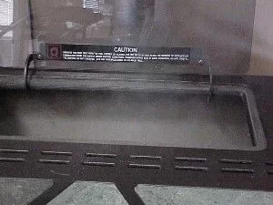

Could that be why when the hopper is say,less then half full, Im getting some, not a lot, of smoke in there? I posted earlier about noticing the smoke again, last April I noticed the smoke and dealer came out and did some tube modification to it, but it was late in the season and I didnt use it much after that so Im not sure if it really fixed it, or is this small amount of smoke normal, with the slider plate opening for the pellet drop, and smoke coming in from the burnpot?

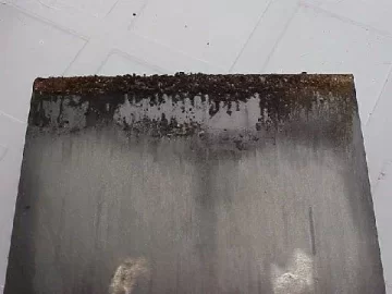

Smoke in the hopper is NOT normal. I'm on my 2nd "replaced under warranty" Harman Advance. Three stoves total installed. I posted here with my problems with it back in 2005-2007 when the problem occured with each of the first two. When the "modification" for the stove was announced, I went on a mission to speak to Harman directly and suceeded. I documented in pictures, smoke coming out of the hopper (only when half to less filled) and photos of the incrusted black charred slide plate). I also posted the photos here last year.

If your getting smoke in your hopper,,,,at the next cleaning...pull your slide plate . If there is black encrusted gunk on it...thats one of the sources of the problem. The wording I used with Harman was....where theres smoke there's fire, and it's a short jump from the auger tube, up the pellet chute to the hopper.

if you have the hopper lid cracked open by a pellet or not snapped down, when you go into low draft mode and when you have less pellets in the hopper several things can happen. you may get a wisp of smoke back in the hopper, especially if your stove is dirty and you have a vent configuration that doesn't promote good natural draft, Ie: direct vent or one with several bends in it.

Toasty is right about alot of smoke and the slide plate, if your slide plate looks like that then you best get the dealer to deal with it the auger and tube will look like the slide plate. By the way thanks for posting those pics....
I should have mentioned the condition of the feed tube and auger with my first stove.....eventually the chain will start jumping and falling off because of the build up and resistance inside the tube and on the auger wings themselves. My first stove was so seized up that the dealer couldn't pull out the auger...I didn't wait that long with the 2nd stove....first puff of smoke that came up from it and I started getting the ball rolling for a replacement right away. If your chain starts jumping and falling off...here's a quick fix to get you throught the season. With the chain off, unit unplugged, hold rocker arm up and turn the augerbackwards,,,You might need to use a hammer and a wrench to get it to budge backwards....you'll hear the charred stuff crunching and breaking off....when you can move it backwards and forwards with little resistance, reattach the chain...easy to do...just use a long screw driver and hold it under the chain with unit on and feeding and guide it on to the moving sprockets . run the unit on test mode and you'll push all the charred stuff out of the auger tube and into the burn pot...you might have to do it a couple of times if there were pellets in the tube. save the charred material for "evidence"...your pieces will be large chunks...and in my case almost a perfect "mold" of the auger wings.
