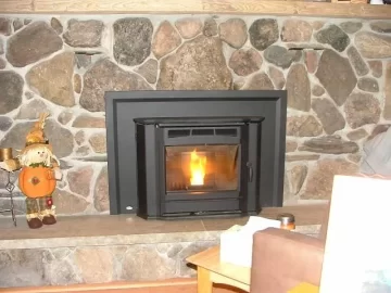

Thanks for the replies.
Attached is a picture of the unit
  • [Hearth.com] Flame intensity on pellet stove?
JW, Your install looks beautiful! Pellets del. in So. NH running at $350 and min. 2 Ton order.
I was told by a dealer that if the damper is open to much the pellets in the pot are burnt up to quick and the pot has to refill for the flame to come back up. He said the pot has to have fuel in it to keep a more constant flame. I lowered my damper and got a more constant flame ,and using a thermometer in the heat exchanger output, got more heat too.
