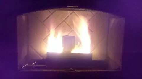

IMO flame hight isn't as important as flame quality. Every stoves burn pot is a little different design so the flame pattern will be a little different. The burn pot on the 6041 has a upside down v welded in the center rear of the burn pot to block the flame from going up the auger chute which creates a v flame pattern. As for the glass the air wash does suck i just open the door every couple days put on my ove glove and wipe the glass with a piece of steel wool to knock the dust off and every saturday when i do my weekly clean i clean it with fireplace glass cleaner.
OK, here is where I'm at! Went to meet my wife at the doctor so I shut down. Got home opened it up cleaned the burnpot and glass. Started all over again! Heat range on #3, Draft fan on #4 agitator on #9! Slide draft open abot 3/8 to 1/2 inch and this is what I have! Seems OK now, but we'll see how long it lasts!! See attached picture.

Flame is much more consistent now. Now on to my next question........I topped off my hopper before going to bed last night @ 10:00. When I got up this morning there was maybe 6 pounds left! The brochure says it holds 60 pounds, I would say when I left it, there was maybe 50 pounds. Heat setting is on #3. Does that sound like a normal rate of consumption or is my unit dumping more than it should. I know that these things don't feed based on the temp in the room if they are on a fixed setting, so I am just trying to predict my usage. I started the other day with three tons in the garage. I have only used about four bags including whats in the hopper now. Keep in mind it has not been running constantly since I started it up on monday. I would say during the 72 hours since I started it, it has actually been on about for about 50 hours. That would put me at about 2.5 to 3 pounds an hour. Sound normal?
