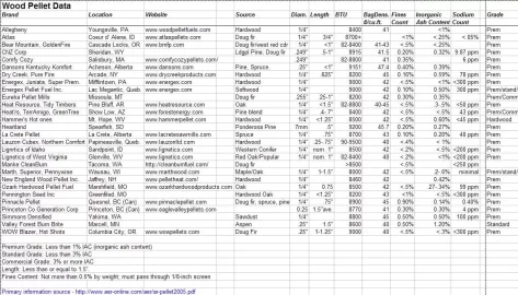

Sounds like they may be the issue if the stove is in good working order. All of the pellets we burned (from several manufacturers) were pretty consistent in length. They were about 3/4 - 1" long. I'd try to pick up about 3 bags of another brand to see if they burn more consistently. A mix of really long pellets and short pellets can cause some bridging in the auger (low flame) followed by a mass of short pellets which could be the source of the high flames. What brands are available in your area?
Take a look at this chart to see which has pellets in the 3/4" range.

The chart is a big help. Thanks again.
