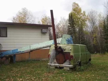

What the difference between residential and industrial ? I have seen 100's of automotive shops over the years with wood heaters in them . What about "detached" garage ? How about a barn ? Or an out building ? Wood shop ? Fix it shop ? Big shed ? An old van parked out back ? O.K. I was kidding about the van . ( or was I ? )

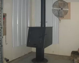

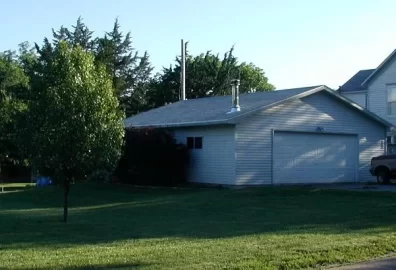

When i installed my wood stove in the garage .................. I built the wood stove and made the pedestal so the stove sits 20" off the floor . I installed the stove just like it would be installed in the house , the stove is so many inches away from the walls , Steel wall shields were installed , the stove sits in a corner by its self with a wall mounted fan . The chimney is single wall pipe to the ceiling boot then its stainless steel through the attic and out the top . No cars sit in the garage unless being worked on . All gas tanks and fuel is stored out in the shed . Paints and such are on the opposite end of the garage in a steel cabinet . The hot water heater thats in the garage bathroom is electric , but sense i weld and use O/A that doesn't make a difference. Because i went thought all the steps to make it safe .......... does it make it right ? No , per code i would say not. I did think it was odd that you can have a LP blast heater and or have floor flame heaters like BrotherBart had mentioned. I install the wood stove because i DIDNT want the "open flame" of the gas heaters in the garage but i guess i find out what i thought was a safer heat source was just the opposite .

No one says your installation could not be safe - it sounds quite safe!
The reason the codes exist is that people don't think about these things that way that you did, and next thing you know they are warming up the paint thinner next to the stove.....and doing various other crazy things.
