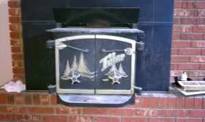

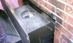

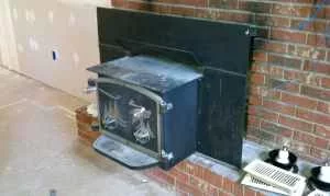

can any one ID this fischer insert? any idea what it was rated for sq footage? I know it is an 8 inch flue. measurements are: the section that slides into fireplace is
25" wide
19.5" deep
21.5" high
thanks and God Bless, ann
trying to figure out if it will work for us will these put out heat without the blower working in case of power outage?

It's a nickel plated "Fisher Fireplace Insert" They were available in black cast iron door, or $50 more for plated door. Later brass with glass doors on a slightly different insert due to air wash under the glass, and side intake draft caps due to no place on the brass and glass door for the intakes.
Here's the manual in Hearth Wiki.
https://www.hearth.com/econtent/index.php/wiki/File:fishinsertmanual.pdf/

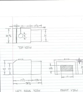

It calls for a minimum of 16" noncombustible material extended from fireplace opening.
Heating area approx. 1750 sf. They were approximated low, so you can count on heating more with a blower. Yes, the blower was an accessory, many were used without. Much more efficient with blower installed. A lot of heat comes off the doors and the 13 inches that sticks out of the fireplace.
Here's a drawing that may help as well.
