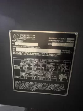

Here is the broke leg. I actually called the person I purchased the stove from and he found the broken piece and is going to send it to me. What would you suggest I use to "glue" it back together? I also have a picture of a good leg (little snow on it).

JB Weld.
It is a 2 part epoxy. Black and white that makes a gray paste. It dries like metal, can be drilled or machined like metal when cured.
