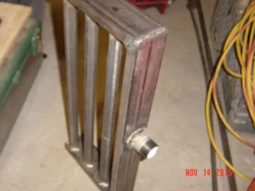

A little while back I purchased a Grandpa fireplace series that had an 8" top flue and barometric control on the rear. I changed the flue to 6" and removed the barometric control.I built a baffle plate that uses firebrick and incorporates a smoke bypass , then built a secondary burner. Each piece is built to fit through the front door and nothing is welded in place for future servicing or design changes. I'll have the stove hooked up tomorrow and light the first fire to cure the paint. I live at 9000 ft of elevation with about a 14' stack. I'm using this to heat a garage, so I had to add a little length to the legs to make the lowest part of the air intake at least 18" from the floor. It'll be a fun experiment to see if we can make the old boy burn hot AND clean while experimenting with secondary burn. Wish me luck!
