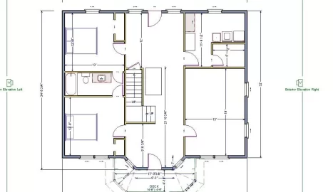

I'm a carpenter by trade and work for a custom home builder. I built the house in 2011 so it's pretty new and has decent insulation. I was actually toying around with the idea of a masonry heater when I built the house but didn't have the money then to put one in, nor do I have that much money now ha.... but I had designed the house with that idea in mind and am hoping it may work alright with a wood stove as well. It's about 2600 sq ft. It's basically a two story rectangle, with an 11ft x 10ft hole in the center of the 2nd story where the stairs go up.There is a half wall surrounding the opening. My main living area (dining/kitchen/familyroom) is upstairs along with the master bedroom.
It's 14ft from what would be the top of the stove before it reaches my 2nd story ceiling. Then another 6 to 8 ft to get through the roof. Being the center of the house, it's going to be real close to coming through at the peak when it penetrates the roof. Basically placing the woodstove near where it shows the rectangle against my steps going up.

Looks like a basic four-square plan with a second first floor bedroom instead of a parlor. The location is good but a lot of the heat is going to go upstairs due to the central location next to the stairs, the chimney like stairwell shaft and the closed off 1st fl rooms. A lot of the first floor space is hall ways which don't usually need as much heat. That said, a convective stove looks like a good idea. How well insulated are the walls and attic?
The walls are decently insulated. I couldnt afford foam or anything... just batted. The ceiling is 11 to 12 inches of blown. I agree that the heat will travel upstairs. Thats why I was wondering about the issues with pushing heat around with my air handler. Especially since my crawl space is conditioned... thanks for reply btw

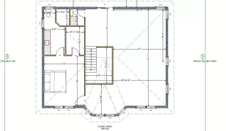

Sorry for the confusion. The stove will be on the 1st floor In the nook created by the turn in the stairs. I guess the second story pic shows the stairwell still saying " up." The 2nd story picture is one large open toom on right and master bdrm on left.

Begreen, your post is like a stake to my heart ha... does this mean that I cannot put a wood stove there? If so, it's pretty much the straw that breaks the camels back as there is really nowhere else for the thing to go due to doors, windows, decks etc in my house. I know I don't need to get a permit to install a wood stove here in my county but do you think the installer will totally balk at putting a stove within 5 or 6 ft of my return? I understand the what and why, I just wonder if it can be done or not. For a hundred bucks the semi-local shop said they'd send the installer out to do a run through on where it would go, measurements etc which would come off our final bill when we go to have the stove installation. I guess maybe that's what I need to do and see what they say. Not that it matters but I feel safer knowing the house was new in 2011 and that all the detectors in here are both fire and Carbon Monoxide.

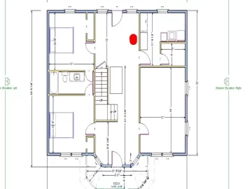

I Domt see the return guide on your blueprint..
I marked a dot a un red for a potemtial new spot for stove. Not sure if their is something above thats makes it no mgood.
