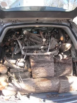

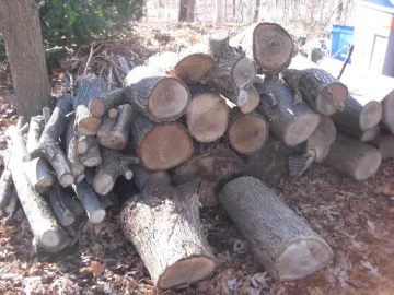

Hi Everyone,
Yesterday, I scored my first scrounged wood for free off craigslist! This wood was about 10 miles from my house, already cut, but not split. Most logs around 1.5 to 2 feet, but some as big as three feet plus. Made two trips, filling up the back of my minivan twice. Not sure what kind of wood this is (the person who had it didn't know, said she thought it was oak). Man am I sore today - I'm no wimp, but loading some of those big logs alone gave my shoulders a real workout! Feels good!!!
I'm a total newbie, so any help you can offer would be great! How can I figure out what kind of wood? My plan is now to get an axe and to start splitting. I'm about to pick up an never used Ludell axe for $25 on craigslist. I hear the Fiskars are better, so I might get one down the line, but have to order on line and want to start splitting asap. I also see I can hire a local guy with a splitter for $26 an hour. Thoughts? How to best stack and store? Etc.

Kenny, I can't tell by the pictures for sure what this wood is. However, I want to congratulate you for getting the wood before getting the stove. That is true wisdom!

EDIT: Was the one you couldn't split in the picture on the left, front row left? That round has a large branch-knot and also looks to have a twist to the grain. Sometimes those will surprise you and bust open, but usually not without substantial effort.

I'm not sure on the wood id either but if you can post some pics of split pieces that may help. Also, take a smell of a freshly split piece, many species are easy to identify that way. :)

WELCOME TO THE ADDICTION! :cheese: From what I can tell by the pics it looks to be silver maple, but can't be sure. It's most likely either that or red maple. get started now, learning the different wood, splitting and stacking techniques, watching for a good deal on a stove and even sometimes class A pipe on both Craigslist and your local classifieds, that is where I bought my Napoleon 1900p for HALF PRICE and it was only one year old! Got my class A pipe for that same stove on ebay for HALF PRICE!! The best thing you could do as an up-and-coming-woodburner is to have joined HEARTH.COM. Great community of people on here, always willing to help you out (and bust yer balls once in a while) ;-P
