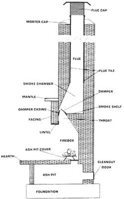

Thank you for the clarification. I am referring to a fireplace. I would like to install the stove in the fireplace. The terms i am using came from this diagram.
It is not an improper term - simply clarifying for us stove guys. Some of us (me) can get confused easily.;)
