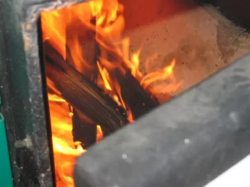

Well nearly two months late but I fired up the boiler for the first time last night (the delays of building a new house....). Worked good. Although the first load I started with was a little small I guess because as soon as I turned the fan on I burned thru it really quick. I loaded more in and it started up pretty fast. Had good gasification, although I see how critical it is to have a good bed of coals over the nozzle as this really changes the gasification flame. Didn't mess around with fan speed or anything like that yet. The smell of the black pipe coming to heat was a little strong at times but I was able to mask that with wood smoke because I kept peeking into the top chamber to see how much wood was left. I now wish it would be colder longer.
Bob
