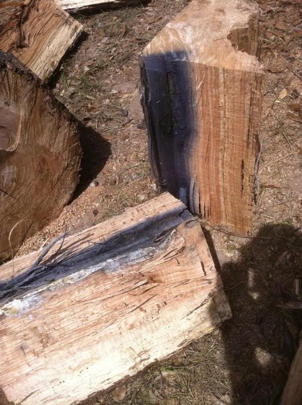

So, when I stood that round up on end to split it I noticed a blue smudge about three inches diameter a few inches in from the bark. I don't think I would have noticed any staining on the bark itself. But, when I split that round, nearly the entire core of the round had a blue stain. I considered that the little smudge might have come from the nail. Hard to believe that the core of that big log was stained by a nail but I don't know how else to explain it.
There you go! Knowing that, in the future with such oaks, you might (and I would):
drop the tree, mark out cut locations for first 10-15 feet, cut through at the 15' mark, and look for the blue stain. If stain found:
Given the intensity of the stain, buck rounds in succession towards the butt, taking care approaching indicated location of the iron.
On suspecting approach to iron, start bucking only part-way, splitting off part of round as possible. Metal detector would help here.
My suspicion is that the tannin in the oak reacts with the iron. As in gun "bluing." And the stain runs purely lengthwise in the wood.

CTYank was spot on about the telltale blue stain in the heartwood caused by metal in the tree. Below is a pic of the splits showing the blue stained core below where the nail was encountered. No satin occurs above the cut where the nail was hit.

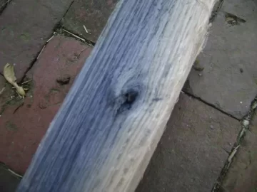

Here is a piece of oak with a nail stuck in it. I saw it grabbed it for a pic before it went into the stack.
  • [Hearth.com] First Encounter of Embedded Metal vs Chain Saw
