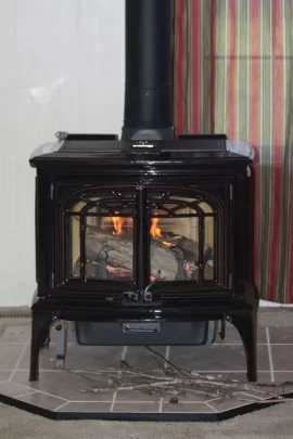

I fired the Leyden for the first time. I brought the stove up to 400 degrees rather gradually according to the Rutland temp gauge mounted on the top lid. We were able to smell some fumes from the paint but they were not anywhere near as bad as I feared. The back plate did smoke after I engaged the secondary combustor by closing the bypass. I opened the window for that even though it was not anything that would really smoke up the house. I did leave the front doors cracked open per the directions regarding first firing.
There were reports of the paint popping off on earlier Leydens and problems with the bypass coming open. I have not seen these problems yet. The back plate states the stove is a year old from the date of manufacture. Perhaps that year allowed the paint to set better or perhaps Lopi improved the paint. I have noticed that Lopi did change the bypass closing device since the 2006 models (mine was made in September 2007).
I was impressed with the amount of heat put out by a small amount of wood. I think the family will prefer this stove over the old fireplace we used last winter.
Additional info – I think the Lopi Leyden is the same or similar to the Avalon Arbor. I’ll let the experts verify that for future readers. The stove is 28-inches from the wall. My wife took the picture with her "bird hunting" 70x300 mm zoom lens. It seems to have compressed the field of depth from 12 feet away. I am having to use single wall connecting pipe for a while since double wall connecting pipe is on back order in this area.

Beautiful looking stove. Nice looking finish too! Have a safe warm winter. From your sig it looks like ya' have all the tools to do so.

Very nice indeed. How close is that curtin to the stove though?

The curtan is 24-inches away. That is still too close in my books considering it could blow around. I closed it to reduce back light for the pic then pushed it back out of the way.
There is a story about why the stove was put there and not where the wife's fireplace still is and you probably already know how it goes :kiss: . There was a better location in the room but it was under a valley in the roof :-S . Another site was too close to the door and the third site was where the Christmas has to go >:-( . The den was not an option and the wife declared she was not going to cook on it in the kitchen :exclaim: . The dining room idea was shot down as well 8-/ . So, I have a new room mate in my office area of the living room. Life is hard sometimes. :red:

Yeah, I hear ya.......I'm well aware how those scenarios play out myself. :down:
Nice looking stove though. Hopefully you (and your wife) will enjoy it and the warmth it produces.

LOL...Thanks for the comments and understanding. :)
You see where her doggies were found after I fired it up. Deb was right in there with them. We are going to have a lot of enjoyment out of it. :)
real nice, I wanna get a stove like that next time. That curtain behind it kinda spooks my though..
Very nice Stove- if I can say so.

Very nice stove BJ! I like the red foxes in front of it too!!!
That was good. Of course I told Deb you called them miniature Coyotes. :lol: :)

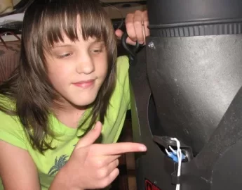

Yes, that is where I put the sensor- between the back of the stove and the heat shield, maybe three inch's down from the pipe conector.
Couldn't get it to go in any futher- too tight a fit with the heat shield.

As you can see mine is put in quite similar. My daughter Samantha likes to see her picture here at "wood pile.com" and she is pointing out how my sensor wires were put in.

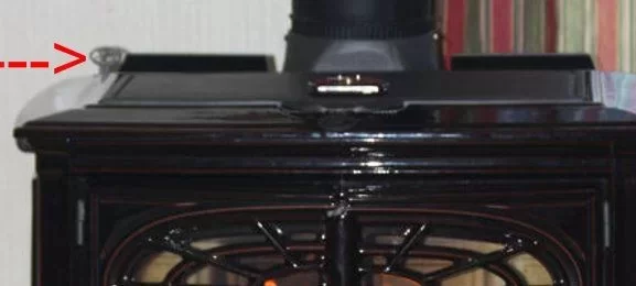

I have seen similar reports of short burn times with the Leyden in the hearth.com stove reviews. I did ask the dealer about that issue and he reported that there was a problem identified with the older models and there was a fix included on mine.
The bypass baffle had a problem of creeping open which would shorten the burn time. Perhaps this could also lower the stove top temps as you have observed since the heat would be escaping out the top past the open baffle. Somebody with knowledge about this will have to tell us. Anyhow; Travis did rig a fix for the matter.
The pictures of red and black stoves are of early model Leydens found on the showroom floor in October, 2006. Note that on the left hand side of the stoves' rear heat shields there is no device visible in the area above the baffle closing level. For the benefit of other readers the baffle closing lever is not visible in the 2006 pictures but it is located on the left side near the back.
The other picture is of my daughter Samantha pointing out the new baffle closing lever lock device on my stove. My stove was built in September, 2007 according to the tag found on the back. The locking device is clearly visible from the front of the stove.
I would hope that this locking device would be available to all early model Leyden and Arbor owners. I think this would be worth bugging your dealer about.

That is great to know about that lever lock. Thanks for sharing. Thankfully, my bypass has never popped open. My stove was manufactured in August of '07, a month before yours. I remember reading the reviews before buying, and I knew the bypass could be a problem, so I asked my dealer. He told me they had corrected the problem, but mine doesn't have that locking device like yours. Maybe they made a correction to the correction. I have to check to see if the new Arbors have that same mechanism shown on your Leyden. Anyway, since my bypass has never opened, that's not the culprit for the poor burntimes. Let me know how your burntimes go. Don't hesitate to PM me about these things. I am curious about how other Leyden/Arbor owners feel about their stoves.

Beautiful stove, Bobby Joe. I like the look of enamel, but don't know if I'd ever get an enameled stove (I'd be worried about chipping it). I bet those 2 "miniature coyotes" camp out in front of that stove all winter. :) Enjoy.
