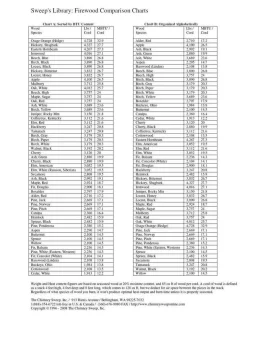

Firewood Comparison Chart
WOODplay
Oct 12, 2010
43
Lower Micigan
Take a look at this site...
(broken link removed to http://chimneysweeponline.com/howood.htm)
Unfortunately, since I don't cut down my own trees, or cut up fallen trees, I'm at the mercy of the guy or gal I choose to buy from. Typically, a wood load will have a mix to it. Some very desirable woods will be in it, and then again, perhaps not so much so. I'd be hard pressed to be able to call around and see if I could buy exclusively one preferred type of wood (say "Black Birch" for example, that has a very high BTU rating).
Would I LIKE to get the most BTU's out of my wood that I'm burning? Sure............
-Soupy1957
This chart was just recently updated and all figures where downgraded a little. Would like to know the explaination as to why but I dont see it? For instance They used to have Red Oak and White Ash at about 24 MBTU. Now they are at about 22 MBTU. Also, they now have Honey Locust higher than Black Locust. It used to be vice versa. And its almost like they just rounded numbers with so many woods being exactly the same MBTUs now. They used to be more specific or exact with each type. Just makes me question the vailidity of the comparison. I know its just a guide but not sure why all the changes......
Wow good eye, have thought there chart was low before.

As far as the charts go, they are calculated by using the average density of each species when it is dry, then using the amount of chemical energy in a cord of wood at that density. Nobody is out there actually measuring the heat output from a wood stove using these woods. I feel that the charts are only a rough guide. How each wood burns in the stove is the final determinant of heat output.
For example, black birch is right about up there with black locust and shagbark hickory. Of the three, the black birch burns fastest, the hickory is second, and the locust burns for a very long time... at least in my stove. What that means is that the birch will put out more heat in a given time than will the locust, even though they all have close to the same BTUs in a cord. Sure, that also means I use more of it in a given time, but the extra heat output per hour can make the difference between a comfortable home and a chilly one.
I understand the calculation....just not why so many changes. And why they rounded the weight for so many species of wood when it appeared to be actual weights before the changes.

Wait about 5 more years and the charts will change again. We must remember these things are guides and not exacts.
This chart is probably maintained by a 18 yr old secretary that doesn't know a wood fire from a gas fire. Or the person that maintains it adjusts it for his own (financial) purposes. Man, am I cynical or what?
They have expanded the list. It used to have 55 wood species now it has 70.
Here is their old chart for comparison.
  • [Hearth.com] Firewood Comparison Chart

Regardless of any changes, which logically would be related to more uniformity in what "dry" or "seasoned" means or in what flue temp is considered the standard, the more interesting number is lbs per cord.
The cord itself is highly variable, as we all have found out. But lbs is a fact, and within a narrow range all wood has the same btu output per pound. In this chart that number is right around 6200 btu/lb and is based on 20% MC and stack temp of 300-350F. I have been using a different number, 6050 lbs/cord, which is derived from 20% MC and 400F stack temp.
With my gasification boiler, I have center of flue temp of 380-430F (about 200F on surface of flue 18" above flue collar). With my wood stove, I have 300-350F on surface of flue 18" above flue collar (about 600F center of flue). My wood is well seasoned and likely is at 20% or somewhat less. Based on my flue temps, I consider the 6050 btu/lb more accurate in my particular situation.
For those who burn less seasoned or green wood, consider that you will burn 2-3 times the amount of wood to get the same heat value as 20% MC wood.
It is also useful to note how these concepts apply to un-seasoned (green) wood fuel. If only seasoned a short time, 50% moisture is a realistic figure. Then a two-pound piece has one pound of wood fibers (worth 8660 Btu). There will be 1.54 pounds of water to vaporize and heat up (taking away 2200 Btu). The two-pound piece has a net available energy content of 6460 Btu or 3230 Btu/pound. This is only HALF of the available energy present when burning seasoned wood. Green wood consumes the bulk of its energy just to keep itself going, and is obviously subject to easily going out.
A freshly cut tree has even higher moisture content, often above 60%. Similar calculations show that this fresh wood has only 2000 Btu/pound of energy available. This explains why it is so difficult to burn freshly cut trees.
