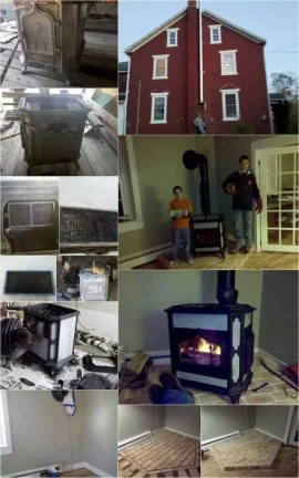

I found a used Woodstock Fireview 205 on Craigslist. On closer inspection, it had been somewhat abused by the prior owners who evidently choked it to death. There were creosote stains on the outside of the stones and the cat was > 50% clogged shut! I replaced the cat with the new stainless model, redid some of the gaskets, and repainted the iron from gray to black.
After building a brick hearth and installing a double-wall chimney (also found used on Craigslist), I installed the stove this week. We're still getting the hang of running it using mostly poplar and a little mixed harder woods like oak and locust.
Since I know you like pictures, here's a collage spanning the several months it took to bring this all together. And...thanks for your help!
