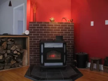

So here's my install. Did some room renovations this summer. Thinking of doing a light sponging technique to get a bit of black in the red wall above the mantel.
