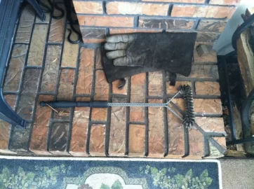

You need one of these for cleaning off that scoop as needed. It will save those arm hairs. [Hearth.com] Fireview Cat Issue
